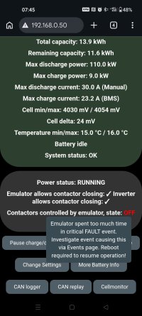

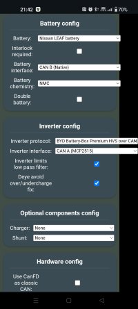

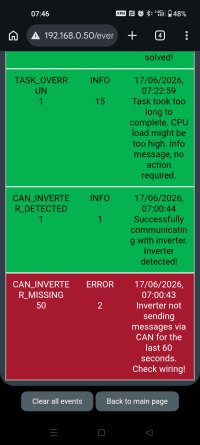

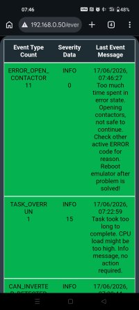

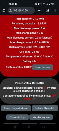

Hello Dala, after update System not working 10.8.0 working ok but 10.10.1 and 10.11.0 have same issue something with contactor control can you help inverter sungrow sh10rt emulator Lilygo T-2Can no change in wires All connected wire its ok working with 10.8.0 without issue
This has been discussed on the Discord. Sungrow is VERY slow to start. We have a pull request with a fix here you can apply: https://github.com/dalathegreat/Battery-Emulator/pull/2466
