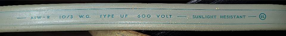

The cable is a UL listed UF with sunlight resistance, and it is a 10/3 AWG with ground.
I'm pretty sure it's a good cable to keep using, but I'm not excited about the way it's mounted to the side of the house.

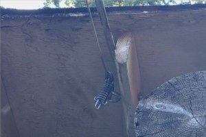

It's just a bit of metal bolted to the cinder block. There is a supporting non-conducting cable that I imagine is supposed to be supporting the power cable, but at no point are they actually attached to each other. On the carport end, the support cable has some kind of shock absorber spring that hooks to nothing.

  2. Install an eyebolt through the cinder block to attach the support cable to the house. And add zip ties or something so the support cable actually does some supporting.

Burying is no good. It's over a concrete slab. The folks over at stack exchange suggested I anker the messenger cable on an eye bolt by itself and secure the cable to the wire. No attaching to the house is necessary for the actual cable. I hadn't thought of that, but it makes sense.

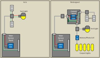

Just for fun, I made a diagram of the existing circuit vs. the new circuits.
I got the old bracket removed, and replaced it with an eye bolt.
I was also able to install the spring thingy so I could give the messenger wire a little tension, but also allowing a bit of give to it in case the carport were ever to sway a bit. Not that it would; its supported by 9 steel pillars which are sunk into concrete.
Anyway, the extra hole is now full of expansion foam. Later I'll seal up the eyebolt hole with some caulk. The eye bolt is in there with one of those lead expansion things, so if the bolt goes, it'll take part of the wall with it.
Now I can hang the cable back up with proper zip ties, and it'll be that much closer to being code compliant.
