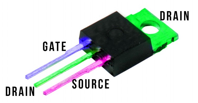

Where is Source, Ground, and Drain on this particular mosfet?
Base = Gate
Collector = Drain
Emitter = Source
The MOSFET has 3 terminals, “gate“, “drain” and “source“, differs from BJT which has “base”, “collector”, and “emitter” terminals. By applying voltage to the gate, you create an electrical field that controls the current flow through the channel between the drain and source, without any current flowing from the gate into the MOSFET itself
Testing them is the same method, though.

Base = Gate
Collector = Drain
Emitter = Source

Thank you Korishan. 😊 Exactly what I was looking for.
