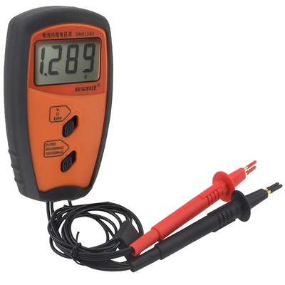

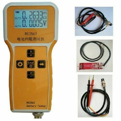

As you know I have just about every IR tester made that is within a reasonable sub $200.00 budget. I'm sure you have seen the pictures of them. But just in case
They are all OK and relatively accurate
For ease of use the RC3563 is my personal choice. Especially when you get it with the holder. Just pop the cell in get a reading and on to the next one. I can process 50 cells in less than 10 min. Checks IR and V at the same time not like the SM8124A.
No fumbling with the probes.
Also the other clear plastic 4 wire holders that come with the YR1035 are quite cumbersome. This one is open and easy to use.

Oh my, that's a lot of IR testers. I've heard the YR1035 is accurate at pretty much any state of charge. Is this the same for the RC3563? I was fairly set on the YR1035 but am now leaning towards the RC3563. Price is around the same range for both.
That is true of the RC3563 also as it is AC IR and does not depend on SOC.
It also has a USB connector and software to see the readings on a screen if you want to.

I ended up ordering the RC3563. Thanks!! Now for the 4-6 week shipping wait...
The cell holder is well worth it, it makes things easier and more reproducible (in my limited experience).
Just don't do what I did. The pin touched the wrong part of the cell and melted :mad::mad:
Yes cell holder is Definitely worth it. I also bought the Premium cables and found them quite good.
