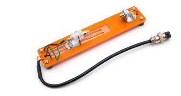

Which of the connections is more standard ?
I'll resolder them to be the same
No don't do that, if you do then when you hook up the Probes, clips, or holder that comes with the meter they will read negative.
I tried using the far superior cell holder from my RC3563 as the connectors are the same however the reading was negative on the YK- VR1220H if you install the cell into the holder the normal way.

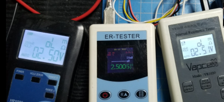

my another ER-1D tester (about 5 years old) is stable and more accurate. Every year or often I am checking all my voltmeters by this device (at the picture). and for the last 2 years, ER-1D has not required a new calibration.
VR1220H is unstable even for 10 minutes

I see you are using the tester at a much higher voltage. I do also have an ER-1D 1690061256141.pngand other than nor being able to import the data I do like it.

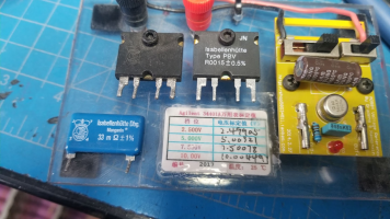

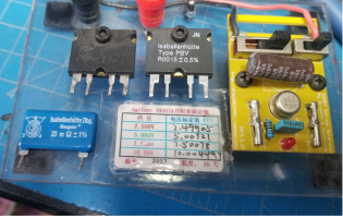

I do too! Funny how we like to make sure our equipment is in top shape. However in my case I don't go much over 10V. I trust my Flukes for that. I also have the same AD584 voltage reference box. Did yours come with a 6 1/2 reference card? mine did not.
I also have another AD584 that did come with a reference card which I incorporated into a V and R tester board with Isabellenhütte 10mΩ ±1%,
1.5mΩ ±0.5%, and a 33mΩ ±1% Resistors.
That gives me a good idea how close any DMM is to a true reference. At least close enough for me.

I also use some resistors but VR1220h is hard to calibrate due to it require exactly 20mΩ ...
