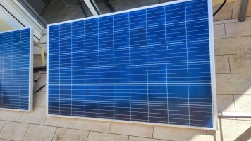

-> I found out something which not many people talk about regarding the PV panels orientation, should I mount them in portrait or landscape orientation? Most of us mount them on the roof or on the ground so it makes not much difference (if there's no shadows). But when you mount them on a balcony the sun won't cover the whole panel until it gets around the building.
( The sun will start from the lower row at the bottom and go up all the way to the top row - production is nothing until the whole panel is covered by sunlight )
What I didn't know is that my 60 cell panels are actually divided in 3x20 cells groups. So it makes a huge different mounting them in one way or the other.
That's my 60-cell panel, it's internally divided in 3 strings in series (S1, S2 and S3). I'm supposing (to be verified) that's my panel setup. I'll do a test rotating it by 90° and I'd expect it to start producing current ad soon as the first series is fully hit by the sun.
[EDIT: I had a closer look, the 3 strings should actually be as the following image]
Yes, good point. Generally it's what fits the space the best. But your next point is very valid as well....
This is probably the most valuable piece of info when setting up panels. How do the shadows lay on the panels as they get lit up? Does the shadow retreat starting at the narrow side and work its way the length of the panel? Then probably want to orient the panel differently. If the light touches the long side and creeps along it then that's what you want.
The cells are most often arranged in series the length of the panel. Some times each 2 rows are a single string, whereas on some each row will be its own string. Each string in a solar panel will have a bypass diode. These are used for when that string is shade, then the current can "bypass" it and keep on moving.
Good point for bringing that up.
Curious, how do you know they are oriented this way? I'm not seeing anything in their datasheet about this
If the panels are truly wired the way you showed, then changing their orientation 90* will be what makes the difference. Because S1 group will start producing full power and bypass S2 and S3 until S2 is in full sun. So you'll see a "stepping pattern" to the power output when each section comes online.
Uhm, I added an EDIT to my previous comment, because I think the cell setup for the PV panel is the standard one, 10 PV cells x 6 rows (I added the correct image), and not that weird asymettric cell disposition I was thinking.
The fact I don't see the expected increase on the inverter's PV IN wattage is because of the inverter's MPPT range 45-145VDC. Until the three strings are fully covered by the sun I don't get the expected increasing wattage (150W -> 300W -> 450W) because the panel's voltage remains too low. It's two 280W panels (Vmp 32.4V, Voc 39.0V).
But the orientation factor still remains valid!

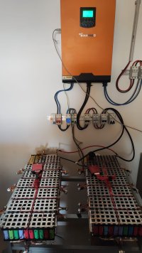

UPDATE - Batteries in parallel
Today it's the first day I'm running with two batteries in parallel, I left the system on all night. Very happy with the result. I have another two batteries to connect but I wouldn't make much sense for now, until I have all the panels mounted.

Yesterday I received the metal shelving unit from AliExpress (shipped from Germany) but it's the wrong size, and I noticed only after mounting it WTH :D it's slightly longer (90cm/35.4" instead of 75cm/29.5") and wider. Asked for refund, approved this morning... I hate having to waste time for this stuff!

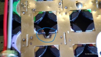

While I was mounting the balancers, twice I had a flying wire touch the battery :eek:... (although there was no balancer physically connected) and boom:
The mounting phase was the usual mess :ROFLMAO::
