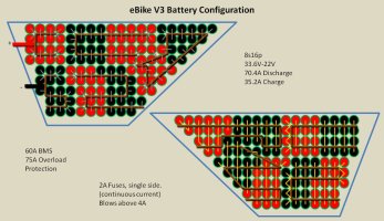

I've been thinking about the best way to manage the battery Voltage vs. the controller and motor's. The battery is 8s16p lithium ion (Samsung ICR18650-22F cells if you want to know) and has a Voltage range of 33.6-22V. The motor and controller are rated for 48V, 1000W, but I don't know what range the controller will accept since it's a no-name with no documentation. I can assume that it's ok between 52.8-42V since it was originally running on a 48V lead acid battery.
I could reconfigure the battery to be 13s, but that would be a lot of work, and I'd need a new BMS, new connectors, and it would still be outside the assumed Voltage range. I think it would be much easier to use a boost regulator. The larges one I've been able to find accepts a maximum current input of 40A, and a maximum load of 1800W.

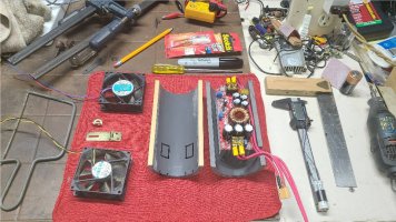

Anyway, since it seems to be working, I need to come up with a safe, ventilated spot to put the booster. I'm currently tinkering with a bit of PVC pipe:

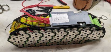

I haven't stopped by in awhile and the thread title caught my attention. (Pardon detour.) I've made several ebike battery packs from laptop cells and it was one of my worst ideas. I repair computers so I had a bunch of cells to work with. I cycled and matched cell capacity but did not use the same brand of cells or cell original capacity when selecting for ebike packs. First season they worked great. Second season I couldn't ride more than a couple miles and it would shut down. I pulled the pack and opened it up. I found leaking cells everywhere. I'm thankful that's all it was. I still build packs but used new matched cells.
I've only done powerwalls / low stress on 18650 cells and not yet seen 'leaking cells'. What caused the leaking do you think? Too high current (cell abuse)? or harsh outdoor / temps? or?
Not temps. Kept inside in the winter and used on nice days in the summer. Cell abuse most likely. It was used pretty harshly on a 1,000 watt mountain bike (30 amp max continuous) and ridden down to BMS cutoff quite a bit and charged to 100% with little or no balancing. Do that to unmatched mixed 18650 cells and some are bound to fail. The leaking surprised me. I'm just glad it wasn't a Lithium fire during charging or the like. That was my first pack ever made. Pack building has come a long way for me and my toys since then. (see below)

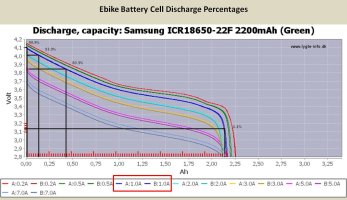

I finally sat down yesterday and did some estimates, approximations, and outright guesses.
When I started my bike ride the other month, the battery was at 32.1V. That's the highest my benchtop power supply will go. When the ride was over, I still had 30.9V, and we had ridden 11 miles. My Amp meter wasn't working, so I don't know that, but I do know that the terrane was almost flat (we could tell that heading back was a little harder than heading out.) We averaged about 10 mph, and I used the motor intermittently, at about 1/4 power.
I worked out that each cell in the battery would have gone from 4.01V to 3.86V. Since cells have seeeexy discharge curves instead of strait lines, I used the following chart from a research lab to estimate some percentages:
Since I averaged about 1/4 throttle, I figure each cell would be experiencing about 1A when in use. Not very scientific, but it's the best I could do. Anyway, I followed the blue curves, and figured I went from 93.9% to 80.3%. With that huge guess, I estimate that the motor uses (with me pedaling on a flat surface) about 1.2% of the battery per mile.
At the moment, I can't charge the battery past 32.1V, or about 93.9%. Also, I have a low voltage cutoff set on the boost converter at 25V, or 1.1%. This keeps the boost converter from drawing more than 40A from the battery. The maximum current input that the boost converter can handle. (The battery itself can handle up to 70A.) That still leaves me with 92.8% of the battery that I can use. So at 1.2% per mile, that gives me a range of about 114.8 miles.

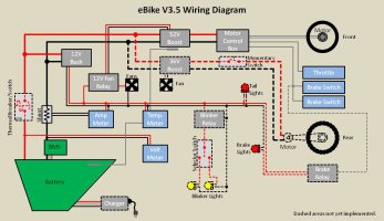

I noticed that a lot of my old pictures and diagrams are not showing up on the first few posts. No wonder, it's a really old thread now. So, since no one asked for it, here are some updated diagrams I've been working on. Now in wide screen!
Now that the bike works, I'm thinking of improvements I can do, to make the whole thing better/safer. I'd like to add a switch to isolate the battery from everything else. While I'm at it, I could get a thermal breaker that would double as a switch and a "fuse". Though most of the thermal breakers I've seen have bad reviews.
Since the boost converter doesn't get hot during actual use, I can eliminate one of the fans. This would allow me to run the other fad directly off the boost converter's 12V fan connector, and eliminate the 12V relay. It also means I could move the second temperature sensor to the battery box and have two sensors on either side watching for hot cells or whatever.
I'm toying with the idea of adding directional blinkers to the rear of the bike. Mostly for my own tinkering enjoyment. Though not having to use hand signals on the street would be pretty nice. I'd also like to add a tail light and brake light. I bet I could add a relay to the brake lever switches to activate the brake light.
I still haven't built a proper charger yet, though I do have all the parts I need stashed away somewhere.
Since the bike has a hard time getting up steep hills even with both me and the motor working, I'm thinking of adding a second motor for short boosts. The voltage booster limits the battery to 40A, but the battery is good to use at 60A continuously, so I'm thinking of adding a 36V, motor and a voltage booster that can do 20A input. I could use the old modified starter motor, but it turned out to be so inefficient that I'd rather save up for a proper brushed DC motor. I looked into a rear wheel hub motor, but most of my bookmarks are broken, and what I've found so far are still way outside my price range.
Also I want to remove the battery box and reinforce it, and do some wire management inside the box. Maybe add some support or cushioning to the battery so all it's weight isn't floating on the three threaded rods. Also better connectors, and other stuff. Paint it. Maybe some waterproofing.
