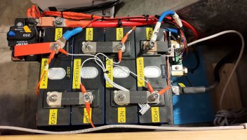

Not sure why the LEDs are lighting up all the way.
What is the voltage of the completed diy battery pack? if 20V it should be lighting up at least two green LEDs I would think possibly even all three green LEDs.
