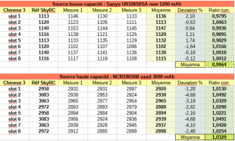

Hello all
If it's of any interest, I've had three 2x4 slot versions of these “Banber” chargers for some time now. I've also calibrated them against my SkyRC MC3000, and here are the results for one of them (the 2 others are similar).
I used 4 cells of 2 types, 1200 mAh and 3000 mAh almost new, averaging 3 measurements for each slot.
The results are almost identical to Wolf's.
