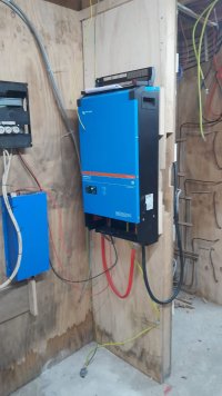

I finally got time to make a ground rod.
My groundwater is approx. 1.8 meters deeper than the top of my concrete floor.(dry period)
Bought a 2-meter galvanized rod, drilled a hole and pounded the rod in...
this is the first out of two needed, the other one will be for the grounding by the house fuse/breaker box.
I am not really comfortable with that one....if there is one btw...
All grounding is saved now, solar, inverter mppts and fuse box in the shed are good now.
For my whole dc side i did not wanted grounding, lucky me it is not needed....
all of my dc side is insulated and no change of open contact, or metal cases ect.
So lightning protection is active, breakers are active grounding is active, inverter is working...
All good, but not perfect
Need to expand
Need to test cells(found a really bad one)
Need to give the cells more room for expansion...
install them with thick pieces of paper when second handed.
When new it is advised to compress them to get some gas bubbles to the top and after 5 cycles space them with 2mm each to allow them to expand during charging.
Now as i noticed the expansion is a real thing and not something to thing light about.
When those cells dont have room to expand they can not hold 100% of there capacity.
Basically, as i found out probably you can even damage your cells and shorten there lifespan.
In this thread i have a picture were i am taking out a single cell with a crowbar.
That whole pack was 280ah, after testing each cell was a average of 240ah is left, after 3 years, and one cell i can throw away.
So they really need room for expansion, eve states even 2mm, i will look for that paper and upload it here
Small update:
All is working like expected, testing bank per bank, so far so good
Not really need to dubbel up my main busbars 300mm2/600MCM is good enough, but to be future ready i will just add a second for a total of 600mm2/1000MCM, more for expansion in the future.
No losses in the cables found when pulling 10kw.
Grounding is done: just 22ohms.
Lightning breakers and grounding switches are all connected also solar boxes.
All fuses are added to "break" a 60kw bank into 3 parts of ~20v.
Connection to the house is "save" meaning i must instal a extra 2x40a ground breaker in the shed.
In the house is done.
Yeah: testing all the cells (for warranty and decay over the years) adding some more safety: like covers, heating protection connected with bms and shut off relais/breakers.
Making a ventilation system that will work on rh and temperature control.
Coating the floor against dust.
Extra ground rod by the house fusebox, the old one is there from the 80's....
Making the grid charger work on the inverter
Adding more solar when roof is done.(3-5kw)
Adding 160+kw on storage extra.....(280-300ah are getting rare, so 314ah*160=160kw, DONT stop me now)
Adding water boiler--->BYE BYE gas connection
Lowering my main grid fuse from 35a to 10a (from 800e a year to 40 euro a year)
They wont be happy with this.....
For fun set up my wind gen that is laying in the shed for over 3 years now unused...
For fun set up ~20kw on NiMh with it.
:( garden work.....
Squeeze on the top shelfs some more storage? i can fit in 128 cell more....
Make a cabinet in the middle for extra 0.5mw
I must stop now...heavy breathing, drooling......several man in white coats just arrived........i must go now
