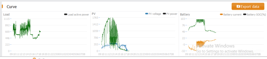

Another really nice chart!
You can see easily when the battery is full :LOL:
For the time being, I think I figured out what I'm going to do with the excess power. Especially after I get the other set of panels put up with the extra battery capacity. Since I can't really use all that power atm, I might as well turn it into heat. And, considering the energy is "basically" free now, the best thing to do is turn it directly into currency. Cryptocurrency!!! 😜 Plus the added bonus of helping to heat the house. Reactivate my Nicehash account, considering they are implementing that surcharge for inactive accounts.
Have the mining work while i'm not home I think would be a good use for the extra energy for the time being.
So this is what the graphs look like while running mining software :LOL:
"very" up/down on the loads
I will say tho, I probably won't do this more until I get the second half of the battery built (which, it has been shipped) which will help smooth out the power usage. I noticed the MPPT would crash several times. This is seen in the middle one where the green fills the graph below the peaks. Compare with the previous image/graph.
The increase in capacity will make it smoother, at least I'm hoping so. Also I want to add more power production. I haven't been able to hook up the other panels yet.
